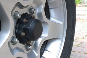

Vacuum operated free-wheeling wheel hub head on a wheel
  • Jimnys have pneumatically (vacuum) operated free-wheeling front wheel hub heads / caps.
  • Pneumatic system is very convenient when it works, but it can be a nightmare when it fails.

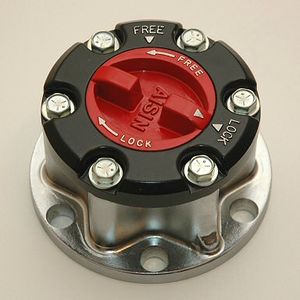

Manually operated free-wheeling wheel hub head
  • The purpose of this article is to provide you an alternative solution to repairing that system - replacing it altogether with manually operated free-wheeling front wheel hub heads.
  • Even fixed front wheel hub heads can be installed (the procedure is almost the same) - this is also covered in this article.

Vacuum (top) and manual (bottom) free wheeling wheel hub head for a comparison
  • Most Jimnys (especially those which are regularly used in all-terrain duty) will, inevitably, have problems with the vacuum system for front wheel hub heads.
  • Diagnosis and repair, depending on the issue, can range from a quick detection and a simple/cheap fix, to a thorough and arduous investigation with expensive repairs.
  • However, there is luckily an alternative solution - to completely discard the vacuum system and vacuum front wheel hub heads, and install manually operated free wheeling front wheel hub heads (like in Samurais and other classic 4WD vehicles) or even fixed hub heads.
  • This will eliminate the entire vacuum system, and with it all the risks and issues which it imposes.
  • Manually operated free wheel wheel hub heads generally have the lowest risk of failures, as there is by far the least amount of components which can fail.
  • The modification is relatively simple to perform, with required parts widely available on the second hand market and/or in the aftermarket.

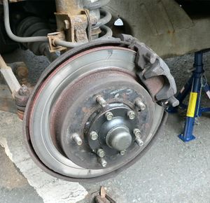

Fixed wheel hub head on a wheel
  • It is also possible to install fixed hub heads.
  • Fixed hub heads are usually much smaller than any other type of hub head.
  • Their availability on the aftermarket for Jimnys is much lower.
  • One possible source of obtaining fixed hub heads would be from a vehicle junkyard which has a dead "el cheapo" 2WD-only Jimny (quite rare, produced from 1998 to 2001).
  • The other possible source would be from a SJ413 (Samurai) and from Vitara Mk1 (and possibly from Vitara Mk2 as well?), but it is not known if some additional spacers are required.
  • The procedure for performing the conversion to fixed hub heads is exactly the same as the procedure for the conversion to manually operated wheel hub heads.
  • Therefore, this article can be fully utilized for that type of conversion as well.
  • The only difference in the end will be that you will never be able to disengage the front wheels from the drive line.
  • This is the same operational effect as when having manually operated wheel hub heads engaged all the time.
