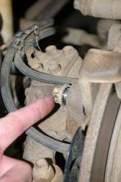

Unbolting the caliper
Using a 12mm spanner, release the front caliper bolt (the left is the front of the car in this picture) and loosen the same bolt on the rear of the caliper.
Open brake caliper
The caliper then opens up using the rear bolt as a hinge.
