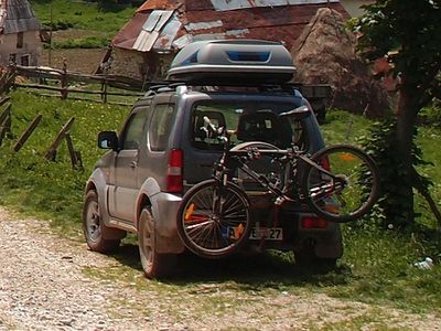

Towbar mounted bicycle carriers are generally a very convenient option for vehicles which have a towbar. It might even pay off to buy and install a towbar just for the purpose of being able to use a towbar mounted bicycle carrier.
However, there are certain restrictions and issues when using towbar mounted bicycle carriers with vehicles which have "classic Jeep style" body, like the Jimny.

Warning Icon.pngBeware that the load limit for most vehicle tow balls is in the range of 50 - 75 kg! You must count in the weight of a bicycle carrier together with the bicycles when doing the weight calculation.

A Jimny carrying a tow hook mounted bicycle carrier for two bicycles (Peruzzo Cruising) with one bicycle on it
