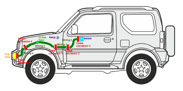

- Factory wiring setup for the front fog lamps is made in such a way that front fog lamps illuminate ONLY when the head lamps are ON as well.
- This means that the front fog lamps will not turn ON even if the in-cabin switch for front fog lamps is pushed IN, until the head lamps are turned ON as well.
- It is not possible to control the operation of each front fog lamp (left and right) independently.
- It's either both OFF or both ON.
- This also means that no fog lamp turns ON automatically when you steer hard on a street corner, like in some fancy modern vehicles.
- If you don't like these restrictions, then you will have to make some custom wiring modifications.

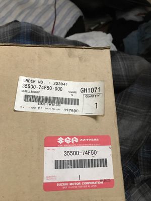

- A pair of fog lamps model 35500-74F50;

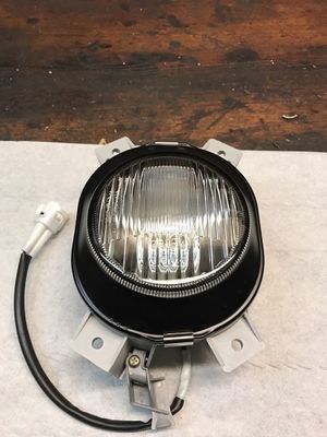

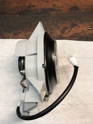

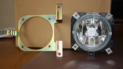

- P.N. 99000-990YZ-035;
- This appears to be a newer "revised" set which replaced the previous set described above.
- This set is stated to be compatible only with Jimnys 3 type 1-4, but not with type 5.
- Type 5 is a "transitional" production edition from 2005 with 1st model front bumper but with 2nd edition interior and electric 4WD controls.
- The probable reason why it is not compatible with type 5 (although the front bumper is the same across types 1-5) is that the wiring might be different.
- Suzuki's OEM accessory catalogues as old as 2006 already offer only this set for Jimnys 3 type 1-4 with 1st. model front bumper, and have no mention of the previous set described above.

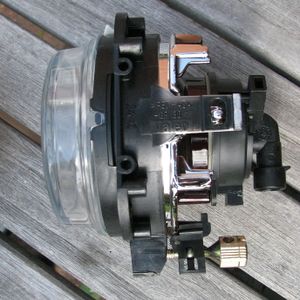

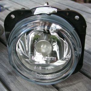

- According to the pictures from a report from a German forum, this set appears to contain the following:
- A pair of fog lamps produced by Cibie (owned by Valeo), model 026719;
- It appears that this Cibie fog lamp is sometimes also referred by another Cibie P.N. 67721231;
- It is not known under which official "OEM" / virtual Suzuki P.N. this fog lamp is catalogued.
- A pair of brackets (P.N. UNKNOWN for left side and UNKNOWN for right side) to mount it to a 1st model front bumper.
- A pair of surrounding bezels for flush cosmetic fitting in the holes in the front bumper (P.N. UNKNOWN);
- One in-cabin button / switch (P.N. UNKNOWN);
- Wiring harness (P.N. UNKNOWN);
- Fuse;
- Various small bits (screws, nuts, bolts, clamps, ties, etc).
- The reason for the inclusion of the bezels for the front bumper is that the included fog lamps do not fit "flush" cosmetically in the holes of a 1st model front bumper (they were not originally designed for it), so the bezels correct that.
- For diesel type 4 vehicles (with 48 kW engine and mechanically operated 4WD transmission), the following are additionally required:
- A relay 95572-63C00-000 (1 piece);
- An adapter cable 99000-990YZ-C13 (2 pieces);
- P.N. 990E0-76J10-000;
- Suffix "-000" should be omitted in some searches.
- It is assumed (but not verified!) that this set contains a pair of front fog lamps, a pair of brackets, a pair of bezels, one in-cabin switch, wiring, relay, fuse and some screws.
- It is assumed (but not verified!) that the included fog lamp model is 35500-63J04.
- This set is officially only for Jimnys 3 type 5.
- The probable reason why it is not compatible with types 1-4 (although the front bumper is the same across types 1-5) is that the wiring might be different.
- It is assumed that the lamps, brackets and bezels in this set are the same as in the set 99000-990YZ-035, but that the wiring is different.
- Complete front fog lamp upgrade set 99000-990YZ-035

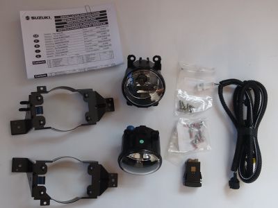

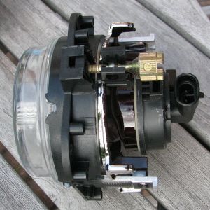

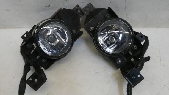

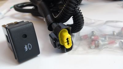

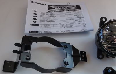

For Jimnys 3 type 6-8 (with 2nd model front bumper):
- P.N. 990E0-84A02-000;
- This set includes:
- A pair of fog lamps model 35500-63J0x;
- It has not been verified what character behind "x" in the part number exactly is.
- It is most probably "4" (35500-63J04), but it could also be "0", "2" ...

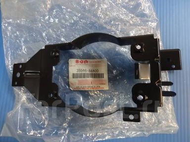

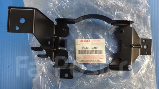

- A pair of mounting brackets - left model 35566-84A00 and right model 35526-84A00;
- Wiring harness between the engine bay and the lamps themselves (section "Wiring 4" from the DIY diagram below) - OEM P.N. UNKNOWN;
- In-cabin button / switch (P.N. UNKNOWN, probably 37270-76J00);
- Various small bits (screws, bolts, etc).
- Complete front fog lamp upgrade set 990E0-84A02-000

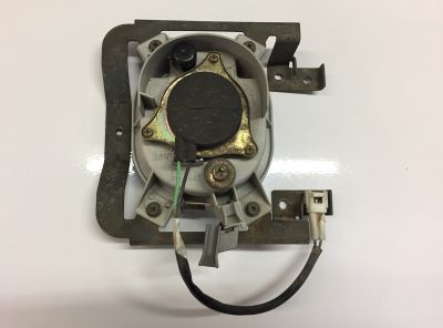

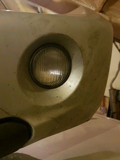

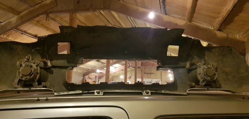

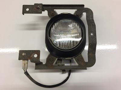

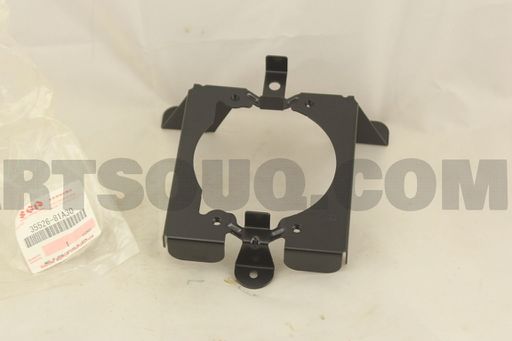

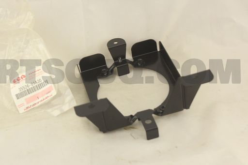

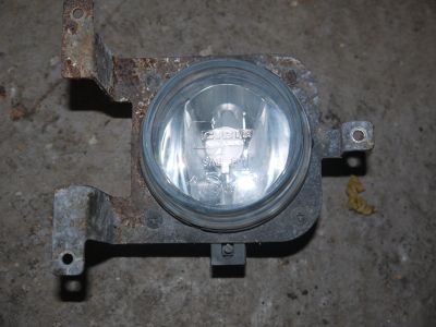

"Fog lamp + bracket" combos

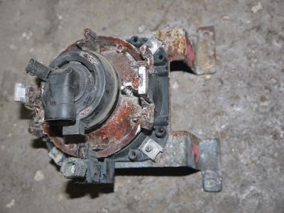

- Fog lamp model 35500-74F50 and bracket model 35526-81A01 are available in a combo set P.N. 99000-990YZ-B01 (for the left side) and 99000-990YZ-B02 (for the right side).
- It is not known why there are two differently named sets (specifically for each side), since both the contained fog lamp and bracket models fit any side equally.
- Perhaps it could be that the fog lamp surrounding bezels model 99000-990YZ-B03 (for left side) and 99000-990YZ-B04 (for right side) are also included respectively (but this is not verified!);
- Fog lamp P.N. 35500-74F50 with bracket P.N. 35526-81A01, taken from 1st model front bumper
- Fog lamp Cibie 026719 with bracket (unknown P.N.), taken from 1st model front bumper
- Fog lamp P.N. 35500-63J04 with brackets 35566-84A00 and 35526-84A00, taken from 2nd model front bumper

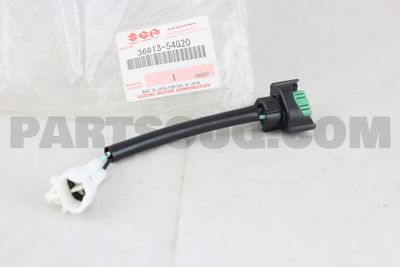

- Probably three different wiring setups (with two different connector shapes);

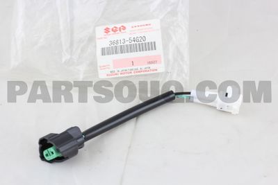

- One available wiring connector adapter at the "fog lamp to wiring" ("Cable connector 5") connection point (for one particular setup combination);

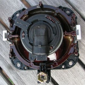

Notes on lamps
- All front fog lamp models are built to suit both the left and the right mounting position in a front bumper.
- Fog lamp model Suzuki 35500-74F50 is actually produced by Stanley, model 010-2587.
- This fog lamp is used on several other vehicle models, so you can find it from other cars as well.
- As evident from the tables above, both the 2nd model and the 3rd model front bumper use the same fog lamps.
- Those fog lamps can also be used in the 1st model front bumper with certain OEM adapters, since that front bumper model has its own different "default" fog lamp model.
- The following three fog lamp models appear to have exactly the same dimensions, shape, bulb, el. connector and mounting points to the brackets:
- 35500-63J04 - "main" / standard edition from Suzuki (with exceptions below);
- 35500-63J02 - meant for the African market;
- 35500-63J00 - used only in Jimnys 3 made by Santana in Spain;
- The actual differences between these three fog lamp models are unknown - possibly beam pattern or clear / ribbed glass?
- These same fog lamps are also used on some Suzuki Alto, Celerio, Vitara 2 (1998-2005), Swift and SX4 vehicle models.
- Another fog lamp model which is often found on Jimnys with 1st model front bumper is produced by Cibie (division of Valeo), model 026719.
- This fog lamp model requires its own specific bracket to mount it to the 1st model front bumper.
- Fog lamp model Suzuki 35500-74F50 / Stanley 010-2587

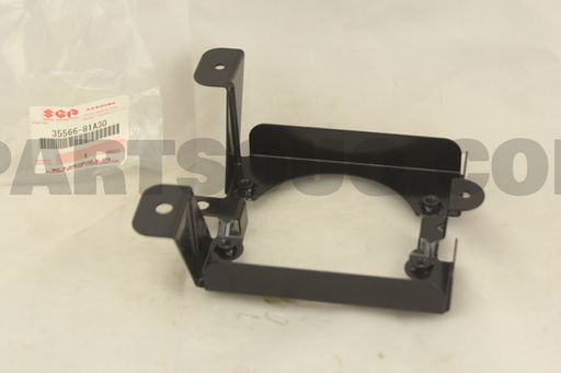

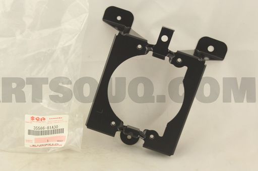

Notes on lamp mounting brackets (carriers)
- Brackets / carriers are required for mounting any fog lamp model to 1st and 2nd model front bumper.
- The actual bracket model depends on the combination (see the tables above).
- The 3rd model front bumper already has fog lamp brackets as its integral part.
- Bracket model 35526-81A01 is the only model which is interchangeable between the left mounting side and the right mounting side.
- Bracket model 35526-81A30
- Bracket model 35566-81A30
- Bracket model 35566-84A00
- 3rd model front bumper - view from inside - enlarge the pictures and note the screw holes in the integrated front fog lamp brackets, to which the compatible fog lamps directly attach

Pictures of lamps and brackets in bumpers
- Appearance of fog lamp 35500-74F50 when mounted in 1st model front bumper - notice that it fits flush without any additional bezels

The wiring setup for the fog lamps in Jimnys 3 is made up of several sections, separated by connectors.

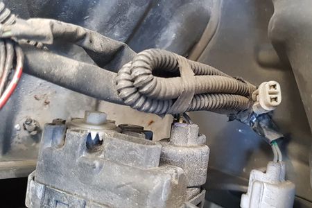

- Some Jimnys 3, which were produced without front fog lamps, still have most of the required wiring elements (cables, connectors, relays, fuses, etc.) for them already installed.
- The best case scenario which you could expect is to already have everything from the above crude diagram already installed from the factory, except Fog lamps + Cable connector 5, Wiring 4 and Switch.
- Therefore, you should first check for the presence of wires with unused el. connectors in the vehicle.
- First search for the unused Cable connector 4 in the engine bay, just behind the head lamps (usually front left).
- If not found there, then search for it somewhere behind the front bumper (after removing the front inner wheel arch liners).
- Then check if the unused Cable connector 3 for the console button / switch is present inside the console in the cabin (see the chapter about the installation of the console button / switch).
- If you find both unused Cable connector 4 and Cable connector 3 (for the fog lamps and for the in-cabin switch) in your Jimny 3, consider yourself lucky!
- In that case, you then only need to obtain the following:
- A pair of fog lamps (with suitable brackets if needed) + Cable connector 5 (usually comes integrated or attached with the lamps);
- Wiring 4;
- Switch;
- Then just connect the following:
- Switch to Cable connector 3;
- Wiring 4 to Cable connector 4;
- Fog lamps to Wiring 4 via Cable connectors 5;
- Mount the fog lamps to the bumper and go on joyful rides ever since.
- If you find no unused Cable connector 3 and/or Cable connector 4 in the vehicle, you will also need to obtain wiring harness kit(s) Wiring 2 (includes Cable connector 2 and Cable connector 3) and and/or Wiring 3 (includes Cable connector 1 and Cable connector 4) as well.
- You can also buy one of complete fog lamp retrofit kits mentioned earlier in the article.
- That way you will eliminate any risk of missing any of needed components.

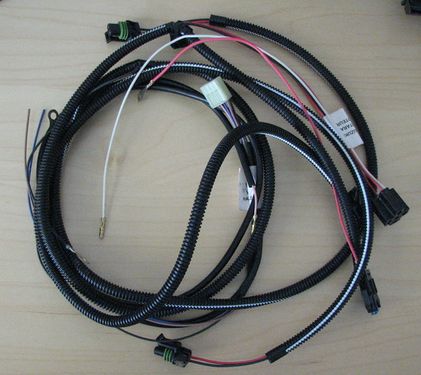

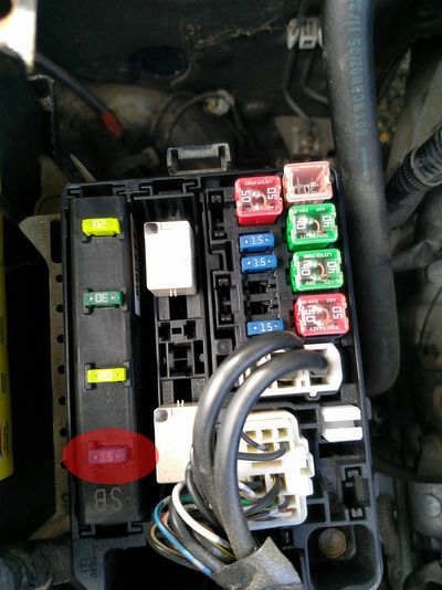

- The OEM wiring harness kit in the engine bay, represented by Wiring 3 + Cable connector 1 + Cable connector 4 in the crude diagram above, is P.N. 99000-990YZ-A05.
- This kit also includes In-line fuse (15A rated current) and a plug to the Relay, but not the Relay itself.
- It is currently not known if this kit is compatible with every Jimny 3 revision and every fog lamp model used!
- However, it is known to be compatible with Jimnys 3 type 1-4 and fog lamps model 35500-74F50.
- The OEM wiring harness kit behind the dash board in the cabin, represented by Wiring 2 + Cable connector 2 + Cable connector 3 in the crude diagram above, is P.N. 99000-990YZ-A06.
- It is currently not known if this kit is compatible with every Jimny 3 revision!
- However, it is known to be compatible with Jimnys 3 type 1-4 (with old style interior console).
- The relay is P.N. 99000-990YZ-A07.
- There is another relay P.N. 95572-63C00 which is instead mentioned in some other catalogues.

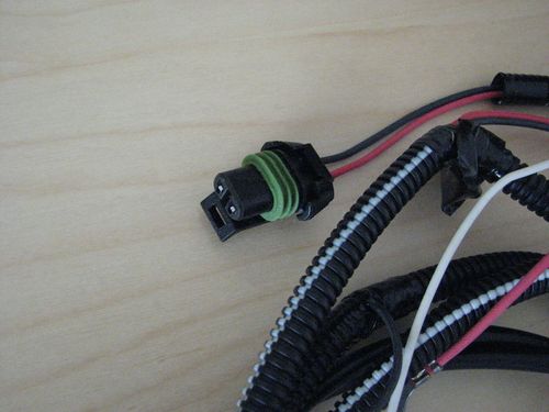

- Wiring harnesses 99000-990YZ-A05 & 99000-990YZ-A06 tangled together
- According to a forum report, it appears that the Cable connector 1 (if present) is located in the engine bay, near the bulkhead, almost behind the battery / below the brake master cylinder (in RHD Jimnys).
- It is a "single bullet" connector.
- According to the same reports, the Cable connector 2 (if present) is located near the wiring loom by the front right speaker (in RHD Jimnys).
- There are 2 main wiring bundles there - it should be in one of those.
Notes on Cable connector 4:
- It appears that this connector is some specific type in Jimnys 3 type 1-5 (with 1st model front bumper) (needs more investigation).
- This connector on Jimnys 3 type 6-12 (with 2nd and 3rd model front bumper) is actually the same male "bullet" type connector as Cable connector 5 in Jimnys 3 type 1-5!
- See notes about Cable connector 5 below for more details.
Notes on Wiring 4:
- It is a split dual wire harness which connects both fog lamps in parallel to Cable connector 4 and is easily removed from a donor vehicle while the fog lamps are being removed.
- This harness is represented by P.N. 36813-84A00 for Jimnys 3 type 6-8 and by P.N. 36813-57M00 for type 9-12.
- The connectors on both of these harness models should be the same.
- These two harnesses are compatible with fog lamps model 35500-63J0x, which all Jimnys 3 type 6-12 use.
- The reason for the existence of two different wiring harness P.N.s is probably because of different mounting clips for attaching the harness to the vehicle body and/or because of different wire lengths.

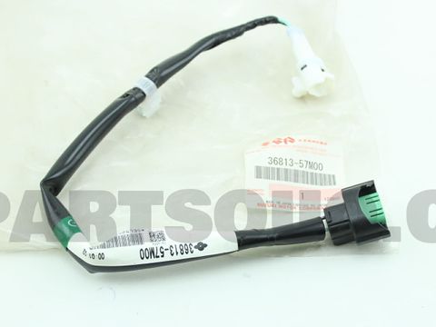

Notes on Cable connector 5:
- There are two types Cable connector 5 for front fog lamps in Jimnys 3.
- The first connector type is a "bullet" type connector, which was used in all Jimnys 3 type 1-5 (which originally came with 1st model front bumper, from 1998 to approx 2005).
- This connector type is compatible only with front fog lamp model 35500-74F50.
- All other / newer fog lamp models which use H11 bulbs (including OEM fog lamps 35500-63J0X) can be connected to the first / old type of Cable connector 5 through a suitable connector adapter 36813-54G20.
- The second / newer Cable connector 5 type was used in all Jimnys 3 type 6-12 (which originally came with 2nd and 3rd model front bumper, from approx 2005 to 2018).
- This newer Cable connector 5 is actually a direct male connector for bulbs made according to H11 bulb standard.
- It is directly compatible with all fog lamp models 35500-63J0X, as these fog lamps use H11 bulbs.
- It is incompatible with front fog lamp model 35500-74F50 (which was not meant for 2nd and 3rd model bumpers anyway, since no brackets for that combination are available).
- However, a required el. connection could probably be made by cutting the Cable connector 5 off and soldering the Wiring 4 to the fog lamps directly.
- Wiring connector adapter 36813-54G20, for certain equipment combinations in point 'Cable connection 5'
- Regarding all the specific details of wiring, refer to a corresponding wiring diagram manual for your vehicle revision (and for donor's vehicle revision if needed).

Console button / switch
Main info
- The switch appears to exist in two editions:
- Older model P.N. 37270-75F10;
- This model presumably fits Jimnys 3 with older (1998-2005) style interior and in-cabin console.
- Newer model P.N. 37270-76J00;
- This model presumably fits Jimnys 3 with newer (2005-2018) style interior and in-cabin console.
- Both switch editions appear the same - add info about the differences and compatibility if you know them!
- The switch is a "permanent press-in" type - after you press it, it stays pressed in until pressed again. The switch also contains a small light indicator which is lit when the switch is pressed in.
- It appears that the same switch has been used for the front fog lamps in Suzuki Vitara 2 (a.k.a. "Grand Vitara") (1998-2005).
- In a Jimny 3, the switch is located next to rear fog lamp switch in a three-switch console cluster.
- The cluster is located to the left of the steering wheel (for LHD vehicles) or to the right of the steering wheel (for RHD vehicles).
- In-cabin front fog lamp switch (P.N. 37270-76J00)
This should be the pinout of the switch P.N. 37270-76J00:
- Pins 1 and 2 are earth.
- Pin 3 is unused.
- Pin 4 is the output to the fog lamp relay.
- Pins 5 and 6 are the "+ve" feed - these are wired to the lighting circuit in the vehicle, as it is not allowed to have the fog lamps on without having the main head lamps on.
- Pin 5 is the power that goes through to the fog lamps.
- Pin 6 is just the feed to illuminate the switch itself.
If you are using some 3rd party 3-wire wiring to connect to the switch P.N. 37270-76J00, then wire it like this:
- Earth - Pins 1 and 2 (connect to BOTH)
- From relay - Pin 4
- From main head lamp circuit - Pins 5 and 6 (connect to BOTH)
- In-cabin front fog lamp switch, unknown source. Probably aftermarket product. Note the presence of only 3 pins instead of 5.
