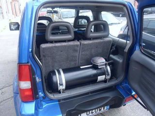

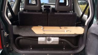

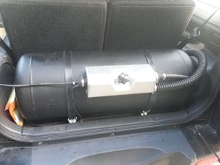

<gallery widths=320 heights=240 class=center>
Suzuki Jimny - LPG - A01.jpg|Example 1
Suzuki Jimny - LPG - B01.jpg|Example 2
Suzuki Jimny - LPG - E01.jpg|Example 3
</gallery>

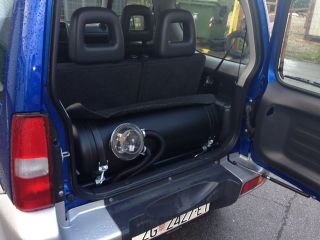

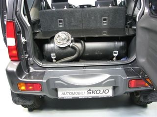

Suzuki Jimny - LPG - C01.jpg|Example 4
Suzuki Jimny - LPG - D01.jpg|Example 5
</gallery>
<br clear=all>

LPG fuel tank in the boot
  • This is the most common choice.
  • Only cylindrical fuel tanks can be used, with a medium capacity at most.
  • The main disadvantage is the loss of (almost) entire boot space, leaving the car with no useful cargo space.
  • The additional disadvantage is that the recessed space in the boot floor (where the vehicle jack, wheel nut wrench, safety triangle etc. are located) will probably be inaccessible after the tank is installed.

  • It can certainly be wider, and it can also be deeper, as there is at least 8 cm of clearance between the factory boot floor and the exhaust muffler under it.
  • Then put and secure a suitably sized cylindrical LPG fuel tank in the new recessed floor.
  • The new floor has to be strong enough to hold the weight of a full LPG fuel tank.
  • The new floor must not be too close to the exhaust muffler, and it should be wrapped in some good heat resistant, heat insulating and long lasting material, to protect the LPG fuel tank from the heat of the exhaust muffler.
  • The LPG fuel tank would still be higher than the current boot floor cover.
  • But the idea is that the top of the fuel tank should be approximately of the same height as the back of the rear seats when they are folded down.
  • Then a custom-made wooden or metal box can be constructed around and over the LPG fuel tank, providing a new raised floor for the boot.
  • The new raised boot floor should be approximately of the same height as the back of the rear seats when they are folded down, enabling smooth surface transition when transporting some large cargo for example, and also enabling relatively normal use of the remaining boot space when the seats are raised.
  • The only disadvantage is having to find a new place to store the vehicle jack, the wheel nut wrench, safety triangle etc.
  • These can all be kept under one of the front seats for example, or on the new raised boot floor.
  • However, having a hydraulic bottle jack and a longer semiprofessional wheel nut wrench instead would probably be better anyway, and neither of those would fit in the factory boot floor recess.
  • All this sounds nice in theory, but someone needs to take specific measures, find suitable LPG fuel tanks and heat resistant+insulating material in order to confirm the feasibility of this idea.
