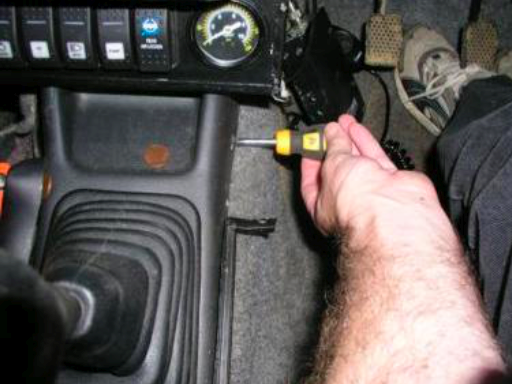

[[File:Figure 1. Removing the Centre Console.png|thumb|left|250px|Figure 1. Removing the Centre Console]]
To remove the gearbox lever you have to remove the centre console. This is held on by four screws on the side at the front and back. The console then lifts out.
[[File:Clutch replacement guide - figure 01 - removing the centre console.png|thumb|left|512px|Figure 01 - removing the centre console]]
Mine was more of a problem as I have a switch panel fitted so I then needed to remove the gearlever before the console would come completely away, but this has to be done at some point anyway.
* To remove the gear box lever, you have to remove the centre console.
* This is held on by four screws on the side at the front and back.
* The console then lifts out.
* Mine was more of a problem as I have a switch panel fitted.

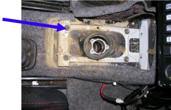

=== Gear levers ===
=== Gear levers ===
[[File:Figure 2. Removing the Gearlever.png|thumb|left|250px|Figure 2. Removing the Gearlever]]
Pull the gaiter away to reveal the three bolt heads around the base of the gearlever, undo the bolts and carefully lift out the gearstick, note that there is a small spring and a cup that should not be lost!
[[File:Clutch replacement guide - figure 02 - removing the gear lever.png|thumb|left|512px|Figure 02 - removing the gear lever]]
* Pull the gaiter away to reveal the three bolt heads around the base of the gearlever.
* Undo the bolts and carefully lift out the gearstick.
* Note that there is a small spring and a cup that should not be lost!
<br clear=all>
<br clear=all>

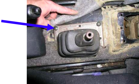

=== Lower Gaiter ===
[[File:Figure 3. Removing the lower Gaiter.png|thumb|left|250px|Figure 3. Removing the lower Gaiter]]
With the console removed you will then see a frame that holds in a second gaiter. Simply undo the bolts and lift the frame clear.
[[File:Clutch replacement guide - figure 03 - removing the lower gaiter.png|thumb|left|592px|Figure 03 - removing the lower gaiter]]
* With the console removed, you will then see a frame that holds in a second gaiter.
* Simply undo the bolts and lift the frame clear.
<br clear=all>
<br clear=all>

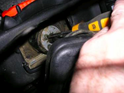

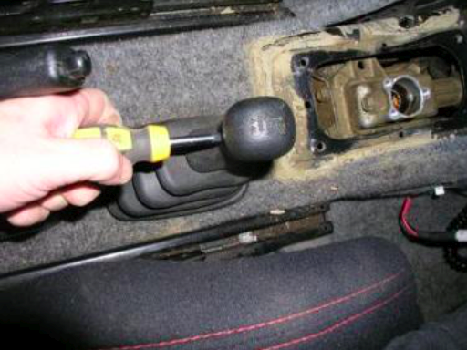

[[File:Figure 4. Removing the Transfer Lever Knob.png|thumb|left|250px|Figure 4. Removing the Transfer Lever Knob]]
If you are removing the Transfer Box then you need to remove the gaiter etc. around the Transfer Box Level. First locate the small screw at the rear of the transfer knob and remove it.
[[File:Clutch replacement guide - figure 04 - removing the transfer lever knob.png|thumb|left|512px|Figure 04 - removing the transfer lever knob]]
* If you are removing the Transfer Box then you need to remove the gaiter etc. around the Transfer Box Level.
* First locate the small screw at the rear of the transfer knob and remove it.
<br clear=all>
<br clear=all>

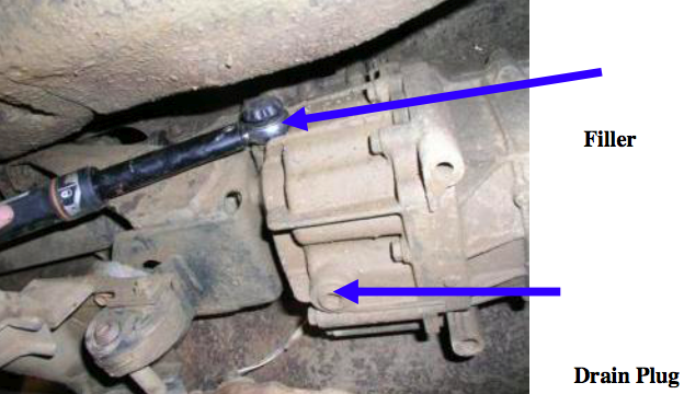

=== Draining the Oil ===
Move outside the car and disconnect the negative cable at battery.
Now drain the oil from the gearbox and transfer box, if you are not doing any work on the transfer box then it is not strictly necessary to drain the oil providing you keep it upright to stop the oil coming out of the lever hole.
On my Jimny the drain plugs are square and therefore a SQUARE 10MM drain plug socket should be used, however the square end of a 3/8 socket driver fits if you are pushed. Always undo the filler plug first because if the filler is stuck you do not want to drain the oil and not be able to fill it again. The gearbox filler is hidden up the side of the gearbox and lack of space is a problem
[[File:Clutch replacement guide - figure 06 - gear box drain plugs.png|thumb|left|624px|Figure 06 - gear box drain plugs]]
* Move outside the car and disconnect the negative cable at battery.
* Now drain the oil from the gear box and transfer box.
* If you are not doing any work on the transfer box then it is not strictly necessary to drain the oil providing you keep it upright to stop the oil coming out of the lever hole.
* On my Jimny, the drain plugs are square and therefore a SQUARE 10MM drain plug socket should be used.
* However, the square end of a 3/8 socket driver fits if you are pushed.
* Always undo the filler plug first, because if the filler is stuck you do not want to drain the oil and not be able to fill it again.
* The gear box filler is hidden up the side of the gear box and lack of space is a problem.
<br clear=all>

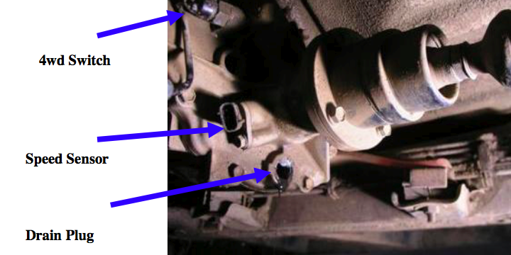

[[File:Figure 7. Transfer Box Fillers and Connectors.png|thumb|left|250px|Figure 7. Transfer Box Fillers and Connectors]]
On the Transfer Box disconnect the 4WD switch wire at coupler and unclamp harness. Then disconnect the speed sensor coupler.
==== Exhaust ====
[[File:Clutch replacement guide - figure 07 - transfer box fillers and connectors.png|thumb|left|720px|Figure 07 - transfer box fillers and connectors]]
* On the Transfer Box, disconnect the 4WD switch wire at coupler and unclamp harness.
* Then disconnect the speed sensor coupler.

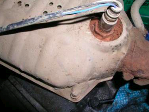

==== Lambda Sensor ====
Do not lift the exhaust of the rubber hangers yet. There is a Lambda sensor connected to the top of the catalytic converter.
[[File:Clutch replacement guide - figure 09 - lambda sensor on converter.png|thumb|left|480px|Figure 09 - lambda sensor on converter]]
* Do not lift the exhaust of the rubber hangers yet.
* There is a Lambda sensor connected to the top of the catalytic converter.
<br clear=all>
<br clear=all>

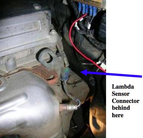

[[File:Lambda Sensor Connector Behind Here.png|thumb|left|250px|Lambda Sensor Connector Behind Here]]
This needs to be disconnected. The Suzuki manual shows the sensor being unscrewed from the top of the converter. However, the sensor has been subject to red hot heat, water and mud, therefore mine was firmly rusted in. Instead I followed the wiring back up to behind the engine. Just behind the head on the passenger side is a set of connectors, unbolt the connector mounting bracket and prise the Lambda connector apart (this is very stiff as well!).
[[File:Clutch replacement guide - figure 10 - lambda sensor connector behind here.png|thumb|left|480px|Figure 10 - lambda sensor connector behind here]]
With the Lambda sensor disconnected you can pull the front exhaust section off the rubber mounts.
* This needs to be disconnected.
* The Suzuki manual shows the sensor being unscrewed from the top of the converter.
* However, the sensor has been subject to red hot heat, water and mud, therefore mine was firmly rusted in.
* Instead, I followed the wiring back up to behind the engine.
* Just behind the head on the passenger side is a set of connectors.
* Unbolt the connector mounting bracket and prise the Lambda connector apart (this is very stiff as well!).
* With the Lambda sensor disconnected, you can pull the front exhaust section off the rubber mounts.
<br clear=all>

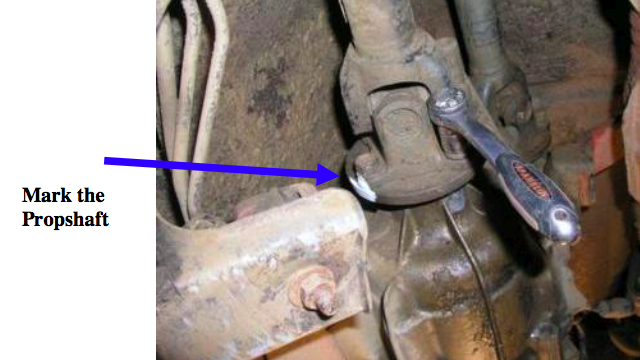

[[File:Mark the Propshaft.png|thumb|left|250px|Mark the Propshaft]]
Now remove the propshafts. On each shaft paint some marks so they can be rebolted to the flanges in the correct position when you are re-building it. Paint all the flanges and also mark the sliding joint in the front propshaft. Remove the FRONT propshaft FIRST, followed by the Gearbox/Transfer box shaft SECOND. Where possible do the REAR propshaft LAST. Why! – because all the propshaft bolts are quite tight and therefore you need to hold the propshafts in place whilst you try to undo the bolts. As the front hubs are vacuum operated there is no easy way to lock the props if you have disconnected the rear first. With the rear prop still on the rear wheels keep the system locked. I found out this trick the hard way.
<br clear=all>
[[File:Clutch replacement guide - figure 11 - mark the propeller shaft.png|thumb|left|640px|Figure 11 - mark the propeller shaft]]
* Now remove the propeller shafts.
* Paint some marks on each shaft paint, so they can be rebolted to the flanges in the correct position when you are re-building it.
* Paint all the flanges and also mark the sliding joint in the front propeller shaft.
* Remove the FRONT propeller shaft FIRST, followed by the gear box/transfer box shaft SECOND.
* Where possible do the REAR propeller shaft LAST.
* Reason - all the propeller shaft bolts are quite tight, and therefore you need to hold the propeller shafts in place whilst you try to undo the bolts.
* As the front hubs are vacuum operated, there is no easy way to lock the propeller shafts if you have disconnected the rear first.
* With the rear propeller shaft still on the rear wheels, keep the system locked.
* I found out this trick the hard way.
{{warning|It is very important to mount all the propeller shafts back exactly as they were, because they were balanced for that position in the factory!}}

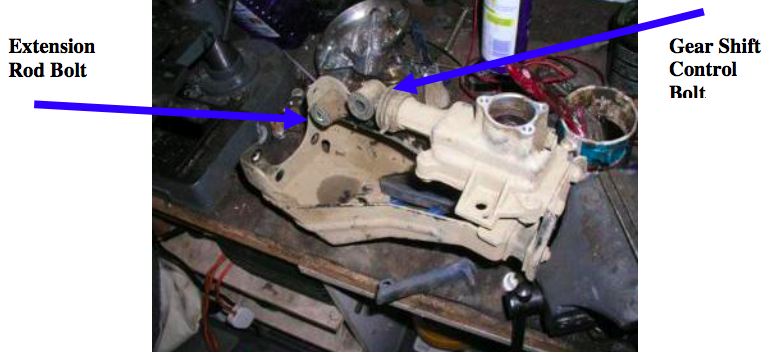

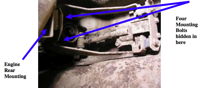

=== Transfer Box ===
[[File:Figure 10. Transfer mounts.png|thumb|left|250px|Figure 10. Transfer mounts]]
Now undo the 3 large mounting nuts on the transfer box mount and the 4 bolts on the mounting flange. Now the transfer box should lift down.
[[File:Clutch replacement guide - figure 12 - transfer box mounts.png|thumb|left|312px|Figure 12 - transfer box mounts]]
* Undo the 3 large mounting nuts on the transfer box mount and the 4 bolts on the mounting flange.
* Now the transfer box should lift down.

Now for the complex bit. The Jimny has a remote gearbox mechanism bolted onto the rear of the gearbox and this needs to be removed. It’s probably easier to see the part after it has been removed as it is clearer what you are trying to achieve. Note this is the top view, you will normally be underneath!
[[File:Clutch replacement guide - figure 14 - gear box remote mechanism.png|thumb|left|768px|Figure 14 - gear box remote mechanism]]
* Now for the complex bit!
* The Jimny has a remote gear box mechanism bolted onto the rear of the gear box and this needs to be removed.
* It’s probably easier to see the part after it has been removed, as it is clearer what you are trying to achieve.
* Note this is the top view, you will normally be underneath and quite nervous!
<br clear=all>
<br clear=all>
[[File:Figure 13. Remote Mechanism in place.png|thumb|left|250px|Figure 13. Remote Mechanism in place]]
Remove gear shift control joint bolt and extension rod bolt.
[[File:Clutch replacement guide - figure 15 - remote mechanism in place.png|thumb|left|800px|Figure 15 - remote mechanism in place]]
* Remove gear shift control joint bolt and extension rod bolt.

Remove the Engine Rear Mounting bolts (Three of them, one either side and one in the rubber bit). This is the mount under the gearbox that rests on the chassis crossmember.
Using a long socket extension, reach into the remote mechanism and undo the 4 bolts that connect it to the gearbox. These are hard to reach.
Remove the Engine Rear Mounting bolts. There are three of them, one either side and one in the rubber bit. This is the mount under the gear box that rests on the chassis crossmember.
Using a long socket extension, reach into the remote mechanism and undo the 4 bolts that connect it to the gear box. These are hard to reach.
The entire mechanism should then be removeable complete with the mounts. Also unbolt all the other metal bits (including the exhaust mounting rubber) from the rear cross member as you will need to squeeze the gear box out later on.
The entire mechanism should then be removeable complete with the mounts. Also unbolt all the other metal bits (including the exhaust mounting rubber) from the rear cross member as you will need to squeeze the Gearbox out later on.

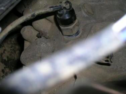

Now remove the reversing light switch. This is on top of the gearbox towards the front and was more accessible from under the bonnet by reaching down the back of the engine on the passenger side (UK). Tie it up out of the way.
[[File:Clutch replacement guide - figure 16 - gear box reverse switch.png|thumb|left|480px|Figure 16 - gear box reverse switch]]
* Now remove the reversing light switch.
* This is on top of the gear box towards the front.
* It was more accessible from under the bonnet by reaching down the back of the engine on the passenger side (UK).
* Tie it up out of the way.

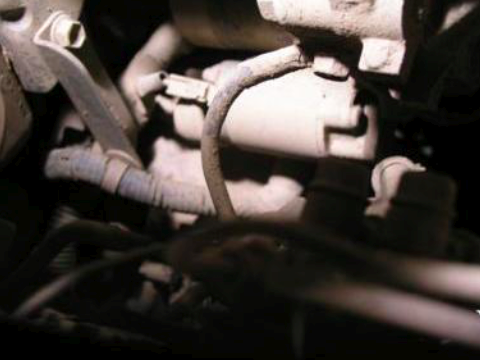

=== Starter Motor ===
[[File:Figure 15. Starter Motor (from underneath car).png|thumb|left|250px|Figure 15. Starter Motor (from underneath car)]]
Now for the next difficult task, removing the starter motor. Clearly Suzuki never considered that a starter motor may go wrong and need replacing as it is in one of the most in-accessible places. First of all check that you have disconnected the battery. Laying under the car reach up the drivers side of the engine and unbolt the two bolts holding the motor in place and easy it back. There is no need to remove it completely and no need to undo all the cables attached to in.
[[File:Clutch replacement guide - figure 17 - starter motor (from underneath car).png|thumb|left|480px|Figure 17 - starter motor (from underneath car)]]
* Now for the next difficult task, removing the starter motor.
* Clearly Suzuki never considered that a starter motor may go wrong and need replacing as it is in one of the most in-accessible places.
* First of all, check that you have disconnected the battery.
* Laying under the car, reach up the drivers side of the engine and unbolt the two bolts holding the motor in place and easy it back.
* There is no need to remove it completely and no need to undo all the cables attached to in.
<br clear=all>

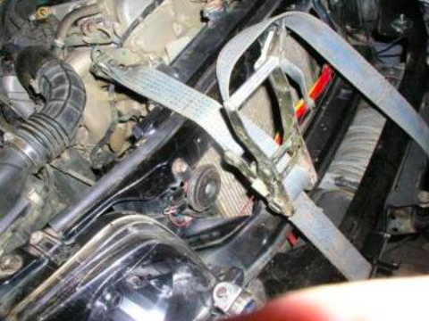

The next problem is undoing them as there is no room to get a socket set in. I had to use a complex combination of extensions and flex joints from two socket sets to get to a couple of the bolts. Also note that there is very little chance of the gearbox falling off once the bolts are undone so don’t spend a lot of time supporting it.
Separating the gearbox from the engine can be a real pain (literally). The gearbox is located on studs and corrosion can hold it in place. I had to hit the bellhousing edge with a large hammer (protecting the metal with a wooden block) before it would separate.
The next problem is undoing them as there is no room to get a socket set in. I had to use a complex combination of extensions and flex joints from two socket sets to get to a couple of the bolts. Also note that there is very little chance of the gear box falling off once the bolts are undone so don’t spend a lot of time supporting it.
[[File:Figure 18. Pulling the engine forward with strap.png|thumb|left|250px|Figure 18. Pulling the engine forward with strap]]
Once it is separated you have to drop the gearbox down. The transmission tunnel is so tight that this appears to be a near impossible task. I had to jack the engine forward to gain as much room as possible. You will also find that the gearbox will move backwards a little way in the tunnel, this means you can then open a useful gap around the clutch.
Separating the gear box from the engine can be a real pain (literally). The gear box is located on studs and corrosion can hold it in place. I had to hit the bellhousing edge with a large hammer (protecting the metal with a wooden block) before it would separate.
[[File:Clutch replacement guide - figure 20 - pulling the engine forward with strap.png|thumb|left|480px|Figure 20 - pulling the engine forward with strap]]
* Once it is separated you have to drop the gear box down.
* The transmission tunnel is so tight that this appears to be a near impossible task.
* I had to jack the engine forward to gain as much room as possible.
* You will also find that the gear box will move backwards a little way in the tunnel.
* This means you can then open a useful gap around the clutch.

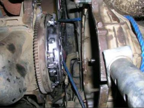

[[File:Figure 19. Gap between gearbox and clutch with engine pulled forward.png|thumb|left|250px|Figure 19. Gap between gearbox and clutch with engine pulled forward]]
[[File:Clutch replacement guide - figure 21 - gap between gear box and clutch with engine pulled forward.png|thumb|left|480px|Figure 21 - gap between gear box and clutch with engine pulled forward]]
Some people have changed the clutch using just this gap. Instead, I undid the clutch cover bolts and removed the clutch assembly with the gearbox still in place. Removing the clutch then meant there was just enough room for the gearbox to be pulled out.
* Some people have changed the clutch using just this gap.
* Instead, I undid the clutch cover bolts and removed the clutch assembly with the gear box still in place.
* Removing the clutch then meant there was just enough room for the gear box to be pulled out.
<br clear=all>

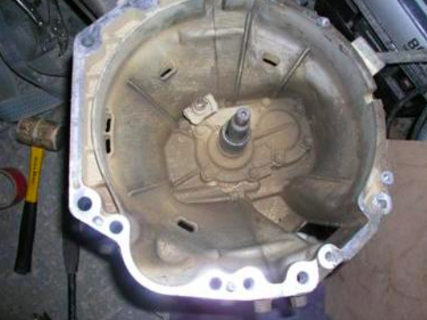

Within the clutch kit should be a new cover, new plate and new release bearing.
[[File:Figure 20. Clutch Release Bearing.png|thumb|left|250px|Figure 20. Clutch Release Bearing]]
[[File:Clutch replacement guide - figure 22 - clutch release bearing.png|thumb|left|608px|Figure 22 - clutch release bearing]]
The old release bearing is removed by prising the spring clip out of the mounting and sliding it out of the spring. Re-assembly is just as easy, make sure that the splines are lightly greased and the inside of the release bearing where it slides on the shaft is greased (not the bearing itself – this should be lubricated by the factory).
* Within the clutch kit should be a new cover, new plate and new release bearing.
* The old release bearing is removed by prising the spring clip out of the mounting and sliding it out of the spring.
* Re-assembly is just as easy.
* Make sure that the splines are lightly greased and the inside of the release bearing where it slides on the shaft is greased (not the bearing itself – this should be lubricated by the factory).

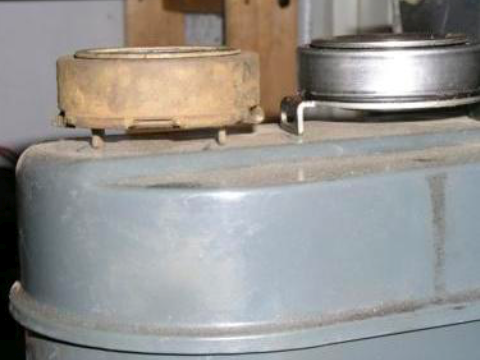

[[File:Clutch replacement guide - figure 23 - wrong release bearing is on right.png|thumb|left|480px|Figure 23 - wrong release bearing is on right]]

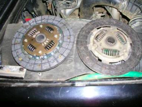

* I originally purchased a cheap kit (CPK1086) from Ebay, this was before the Bigjimny shop!
[[File:Figure 21. Wrong Release Bearing is on Right.png|thumb|left|250px|Figure 21. Wrong Release Bearing is on Right]]
* The quality seems OK (it is stamped as being made by AISIN – who supply Suzuki with parts).

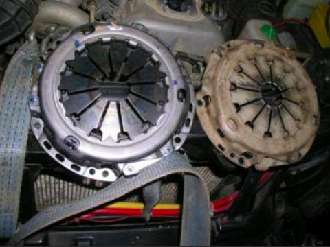

The pictures below shows the clutch mechanism. I purchased a cheap kit (CPK1086) from ebay. The quality seems ok (it is stamped as being made by AISIN – who supply Suzuki with parts), the only issue being that it was supplied with the incorrect release bearing. The company immediately shipped the correct bearing free of charge and assured me that the correct bearing should have been in the kit. Also note that the new plate has 4 springs whilst the old one has 3, again I have been assured that this is ok.
* The only issue being that it was supplied with the incorrect release bearing.
* The company immediately shipped the correct bearing free of charge and assured me that the correct bearing should have been in the kit.
* Also note that the new plate has 4 springs whilst the old one has 3, again I have been assured that this is OK.

[[File:Figure 23. New clutch cover on left.png|thumb|left|250px|Figure 23. New clutch cover on left]]
[[File:Clutch replacement guide - figure 25 - new clutch cover on left.png|thumb|left|480px|Figure 25 - new clutch cover on left]]

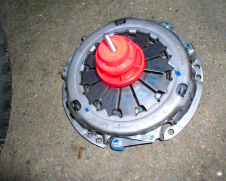

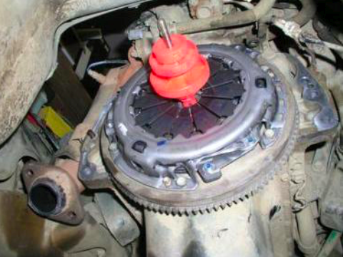

Assemble the new clutch mechanism using a clutch alignment tool (I got mine cheap - £1 – as it was a girlie pink colour and had remained unsold in the shop for a long time). With this tool you assemble the clutch off the car and then lift the whole unit into place and bolt down the clutch cover to the flywheel. Remove clutch alignment tool.
[[File:Clutch replacement guide - figure 26 - clutch assembled.png|thumb|left|480px|Figure 26 - clutch assembled]]
[[File:Figure 24. Clutch Assembled.png|thumb|left|250px|Figure 24. Clutch Assembled]]
* Assemble the new clutch mechanism using a clutch alignment tool.
* I got mine cheap - £1 – as it was a girlie pink colour and had remained unsold in the shop for a long time.
* With this tool you assemble the clutch off the car and then lift the whole unit into place and bolt down the clutch cover to the flywheel.
* Remove clutch alignment tool.

[[File:Figure 25. Clutch with alignment tool.png|thumb|left|250px|Figure 25. Clutch with alignment tool]]
[[File:Clutch replacement guide - figure 27 - clutch with alignment tool.png|thumb|left|448px|Figure 27 - clutch with alignment tool]]
<br clear=all>

Starting inside the car it is necessary to remove the console, the gear lever and the transfer box lever.
Centre Console
  • To remove the gear box lever, you have to remove the centre console.
  • This is held on by four screws on the side at the front and back.
  • The console then lifts out.
  • Mine was more of a problem as I have a switch panel fitted.
  • Therefore, I then needed to remove the gear lever before the console would come completely away, but this has to be done at some point anyway.
Gear levers
  • Pull the gaiter away to reveal the three bolt heads around the base of the gearlever.

Lower Gaiter
  • With the console removed, you will then see a frame that holds in a second gaiter.
  • Simply undo the bolts and lift the frame clear.
Transfer Lever
  • If you are removing the Transfer Box then you need to remove the gaiter etc. around the Transfer Box Level.
  • First locate the small screw at the rear of the transfer knob and remove it.
Figure 05 - removing the transfer level gaiter
  • Unscrew the frame around the gaiter and pull the frame and gaiter clear.
Draining the Oil
  • Move outside the car and disconnect the negative cable at battery.
  • Now drain the oil from the gear box and transfer box.
  • If you are not doing any work on the transfer box then it is not strictly necessary to drain the oil providing you keep it upright to stop the oil coming out of the lever hole.
  • On my Jimny, the drain plugs are square and therefore a SQUARE 10MM drain plug socket should be used.
  • However, the square end of a 3/8 socket driver fits if you are pushed.
  • Always undo the filler plug first, because if the filler is stuck you do not want to drain the oil and not be able to fill it again.
  • The gear box filler is hidden up the side of the gear box and lack of space is a problem.
  • On the Transfer Box, disconnect the 4WD switch wire at coupler and unclamp harness.
  • Then disconnect the speed sensor coupler.

Lambda Sensor
  • Do not lift the exhaust of the rubber hangers yet.
  • There is a Lambda sensor connected to the top of the catalytic converter.
  • This needs to be disconnected.
  • The Suzuki manual shows the sensor being unscrewed from the top of the converter.
  • However, the sensor has been subject to red hot heat, water and mud, therefore mine was firmly rusted in.
  • Instead, I followed the wiring back up to behind the engine.
  • Just behind the head on the passenger side is a set of connectors.
  • Unbolt the connector mounting bracket and prise the Lambda connector apart (this is very stiff as well!).
  • With the Lambda sensor disconnected, you can pull the front exhaust section off the rubber mounts.
  • Now remove the propeller shafts.
  • Paint some marks on each shaft paint, so they can be rebolted to the flanges in the correct position when you are re-building it.
  • Paint all the flanges and also mark the sliding joint in the front propeller shaft.
  • Remove the FRONT propeller shaft FIRST, followed by the gear box/transfer box shaft SECOND.
  • Where possible do the REAR propeller shaft LAST.
  • Reason - all the propeller shaft bolts are quite tight, and therefore you need to hold the propeller shafts in place whilst you try to undo the bolts.
  • As the front hubs are vacuum operated, there is no easy way to lock the propeller shafts if you have disconnected the rear first.
  • With the rear propeller shaft still on the rear wheels, keep the system locked.
  • I found out this trick the hard way.
  • Now for the complex bit!
  • The Jimny has a remote gear box mechanism bolted onto the rear of the gear box and this needs to be removed.
  • It’s probably easier to see the part after it has been removed, as it is clearer what you are trying to achieve.
  • Note this is the top view, you will normally be underneath and quite nervous!
  • Remove gear shift control joint bolt and extension rod bolt.
Engine Mounting
  • Now remove the reversing light switch.
  • This is on top of the gear box towards the front.
  • It was more accessible from under the bonnet by reaching down the back of the engine on the passenger side (UK).
  • Tie it up out of the way.
Starter Motor
  • Now for the next difficult task, removing the starter motor.
  • Clearly Suzuki never considered that a starter motor may go wrong and need replacing as it is in one of the most in-accessible places.
  • First of all, check that you have disconnected the battery.
  • Laying under the car, reach up the drivers side of the engine and unbolt the two bolts holding the motor in place and easy it back.
  • There is no need to remove it completely and no need to undo all the cables attached to in.
  • Once it is separated you have to drop the gear box down.
  • The transmission tunnel is so tight that this appears to be a near impossible task.
  • I had to jack the engine forward to gain as much room as possible.
  • You will also find that the gear box will move backwards a little way in the tunnel.
  • This means you can then open a useful gap around the clutch.
  • Some people have changed the clutch using just this gap.
  • Instead, I undid the clutch cover bolts and removed the clutch assembly with the gear box still in place.
  • Removing the clutch then meant there was just enough room for the gear box to be pulled out.
  • I originally purchased a cheap kit (CPK1086) from Ebay, this was before the Bigjimny shop!
  • The quality seems OK (it is stamped as being made by AISIN – who supply Suzuki with parts).
  • The only issue being that it was supplied with the incorrect release bearing.
  • The company immediately shipped the correct bearing free of charge and assured me that the correct bearing should have been in the kit.
  • Also note that the new plate has 4 springs whilst the old one has 3, again I have been assured that this is OK.
Figure 24 - new clutch plate on left
  • Assemble the new clutch mechanism using a clutch alignment tool.
  • I got mine cheap - £1 – as it was a girlie pink colour and had remained unsold in the shop for a long time.
  • With this tool you assemble the clutch off the car and then lift the whole unit into place and bolt down the clutch cover to the flywheel.
  • Remove clutch alignment tool.
Figure 28 - clutch back in place
