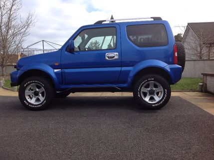

Standard Jimny 3
- An unmodified 2005 VVT Jimny 3 (UK) for comparison.
