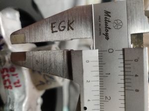

- 10B.Inspect your standard Jimny wheel. Do you see it has two round holes at the back, on the mating surface to the indicator canceller? These two holes you need to replicate on your replacement wheel.
- 10C.Holes sit exactly center on the wheel and they are 3mm deep.
- 10D.Using a dremel make the holes.
- 10E.Depending on what kind of replacement wheel you have chosen, you need to delete the indicator cancelling bumps on the new wheel. In my case, the replacement wheel being from a Swift, I need to grind down the areas marked in red with a grinder.
