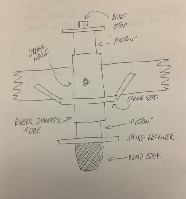

09 Apr 2022 21:15 #242808
Replied by X8GGY on topic Dave’s long-term Lil’Bugga Buggy Build
This project is obviously stalled as I’m incarcerated in various hospitals, but that gives my sick mind longer to come up with ideas…
lilbugga.wordpress.com/
I particularly like this one…
lilbugga.wordpress.com/2022/04/09/dislocating-spring-bump/
Dave
Dave

10 Apr 2022 04:06 #242812
Replied by Lambert on topic Dave’s long-term Lil’Bugga Buggy Build
Interesting idea. Keeping the slides clean could be problematic as they could wear very quickly otherwise. But it has potential. Would you also have a weaker spring inside the tube then when extended you are still applying downward pressure on the tyre beyond gravity to aid tractive effort?

10 Apr 2022 08:33 #242816
Thanks Lambert…
That’s my original sketch above (for the benefit of others): so you mean a smaller helper spring in here -
That looks plausible too!
iI’ll add that to the blog and credit you with idea!
Keeping it clean… pressure washer and add more grease through the grease nipple and smear some over the exposed piston inner tube between outings…
