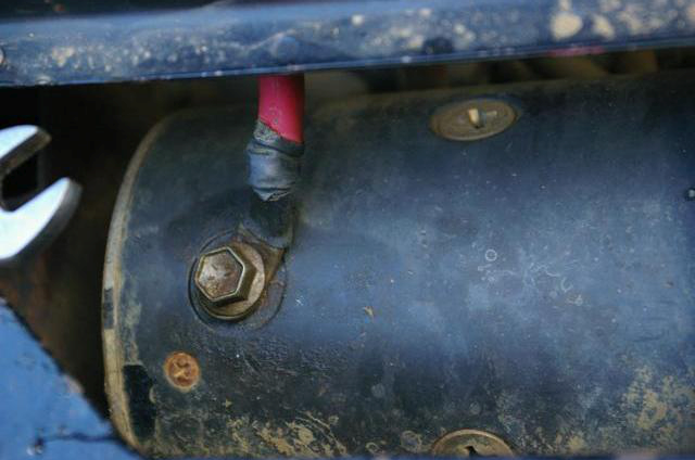

  • The motor will probably have an earth lead under the motor running from the solenoid (I know mine is coloured red!).
    • A sensible installation would have this in black!

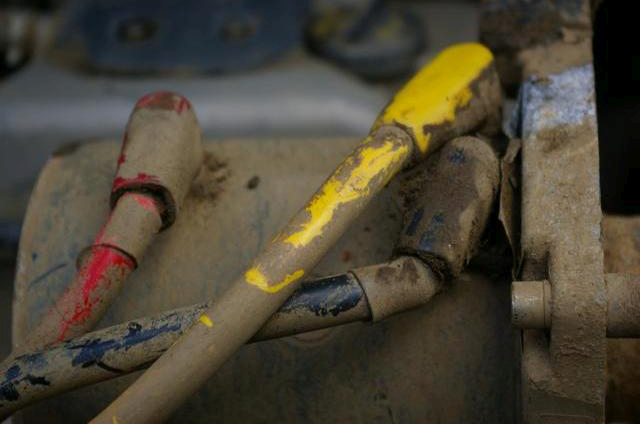

Figure 02 - motor power and field connections
  • On the other side of the motor will be the power and field connections also running from the solenoid.
  • These will be colour coded and WILL be different to mine shown in the picture.
    • Therefore, make a note of where yours connect to.
  • Also be very careful undoing these.
  • The other end of the stud inside the motor is connected to a wire.
  • If the stud rotates, it will break the wire.
    • Therefore, make sure as you undo the nut securing the cable, that the stud is held fast and is not allowed to rotate.

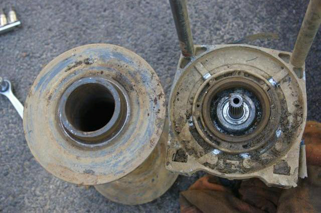

Figure 03 - motor and drum separated
  • Carefully part the drum, motor and gear box.
  • At this point some parts may fall out.
  • The first is a hex shaped bar that comes out of the centre of the drum and goes to the gear box.
  • If this has not fallen out, then gently pull it out and put it aside.
  • The other part is a cup that sits on the end of the motor (inside the drum) and connects to the brake mechanism in the drum.
    • Again look closely at how the cup fits and put it to one side.

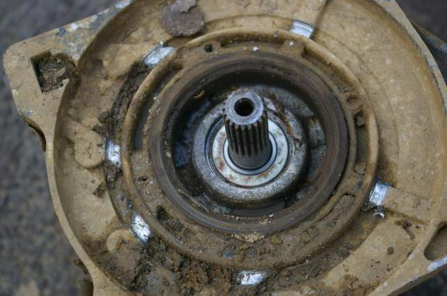

Figure 04 - drum brake stuck in drum
  • Inside the drum will be a cone brake (if your winch has a drum brake – more expensive winches have the brake in the gear box).
  • Typically this will be stuck inside the drum (this picture shows mine).
  • Note the dog ears that match up with the cup on the end of the motor that you have just removed.

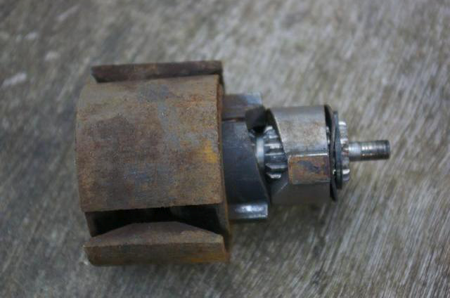

Figure 05 - cone brake
  • You will need to gently drive the brake mechanism out if it is stuck.
  • This picture shows my brake once it is removed.
    • Note: you can usually only drive it out in one direction.
    • But helpfully I can not remember which direction that is!
    • There is a step machined inside the drum to stop it going the other way.

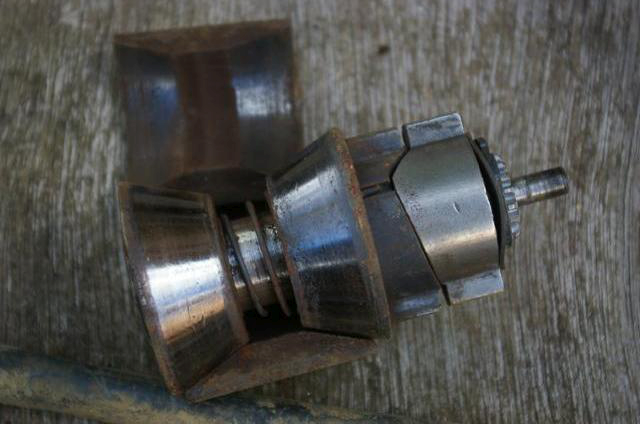

Figure 06 - cone brake parts
  • The cone brake is a simple cam mechanism that pushes the three loose brake shoes out against the drum.
  • This needs a simple clean up, lubrication of the moving parts (not the shoes!) and putting aside ready for re-assembly.

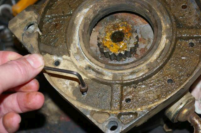

Figure 07 - removing the end plate
  • Now it's the time to tackle the gear box.
  • The gear box will be held to the drum end plate by some small screws.
  • In my case these are hex socket headed bolts.

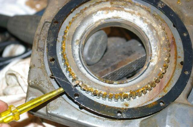

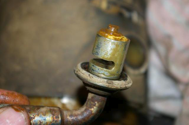

Figure 08 - gear box case seal
  • On the back of the end plate is a seal which should not be lost!

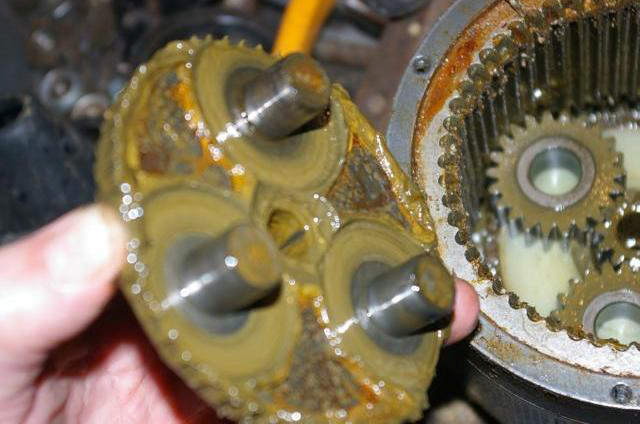

  • Each layer consists of a plate with “pegs” and a set of gears.
  • The pictures below show the progress through the layers.

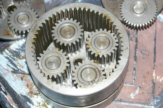

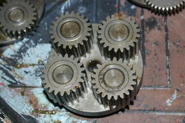

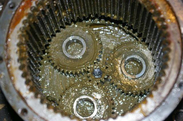

Figure 11 - layer 1 with four heavy duty gears

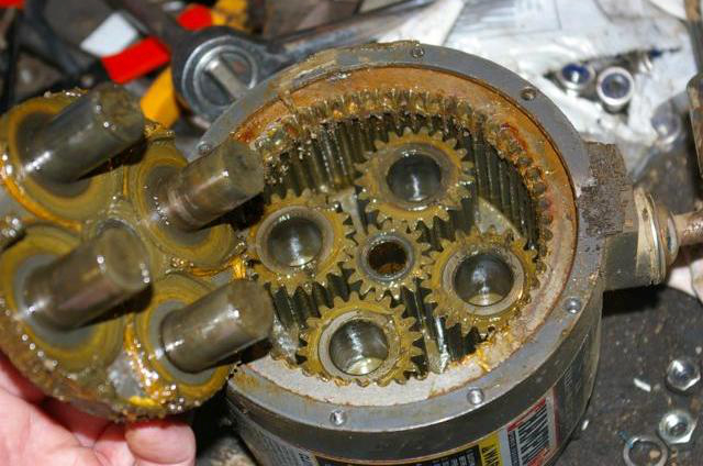

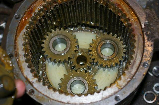

Figure 12 - layer 2 gears

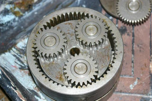

Figure 13 - layer 2 and the plate with "pegs"
Figure 14 - layer 3 gears (the thinnest)

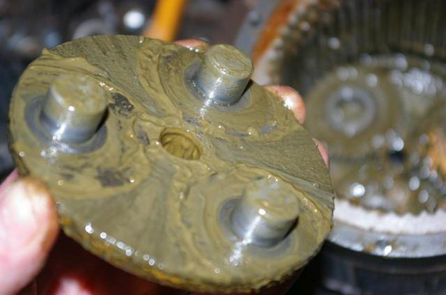

Figure 15 - layer 3 plate

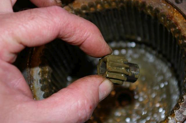

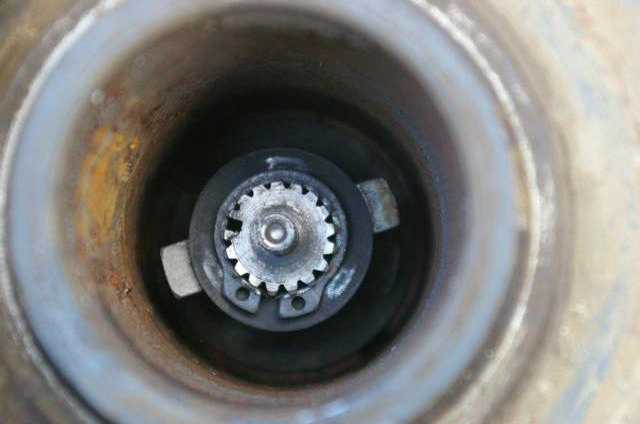

figure 16 - small drive gear at bottom of gear box
  • The final layer also has a small loose gear that sits at the very bottom and takes in the drive from the hex shaft that leads from the drum.

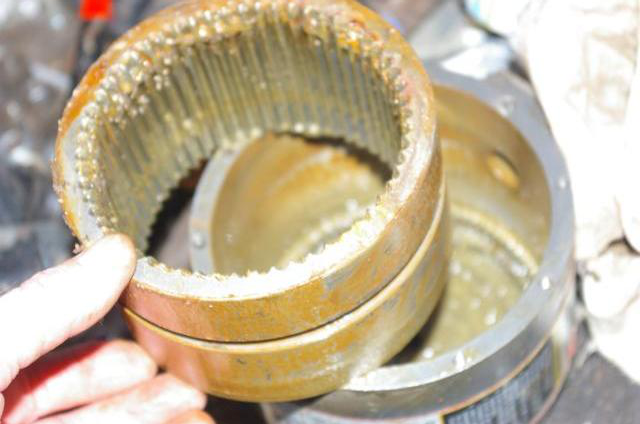

Figure 17 - clutch ring
  • At this point, the clutch ring can be slided out of the casing.

  • The four heavy duty output gears are built up on their plate.
    • Note: The photos are of a "dry" run to check if it all fits - you would normally plaster them in grease!

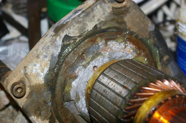

Figure 22 - greasing the frame/casing joint
  • With the casing removed, the motor is exposed.
  • There are not a lot of user serviceable parts in the motor.
  • However, a good cleanup is worthwhile.
  • Water had got in somehow, so there was a lot of rust around.
  • I cleaned out the casing and put grease on where the casing mounts to the frame.

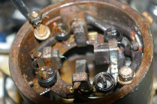

Figure 23 - motor brushes (see how the stuck ones have not sprung forward in their mounts)
  • At one end of the motor sits the brushes.
  • These are spring mounted, so that they can move as they wear.
  • It looks as if they are not replaceable on my motor.
    • However, there is an element of maintenance that you can do anyway.
  • Check that each brush moves freely in its mount.
  • Mine were rusted up and not able to move.
  • I gently eased them into moving using WD40 and 3in1.

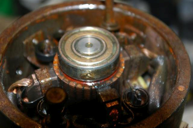

Figure 24 - motor assembly completed
  • Once the brushes are working, the motor can be re-assembled.
  • You have to hold the brushes back, otherwise they foul the commutator as you try and re-assemble it.
